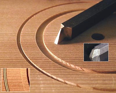

I'm not sure if we're talking the same type of cutter here, but here's what I do. The photo shows two different bits and how I ground them. At places (like MSC?) the bits are about a dollar each.
PostPosted: Mon Feb 28, 2005 6:02 am
Yeah Pete, that's the idea! Looks like you've found an even cheaper source than I did. Thanks for the info!
